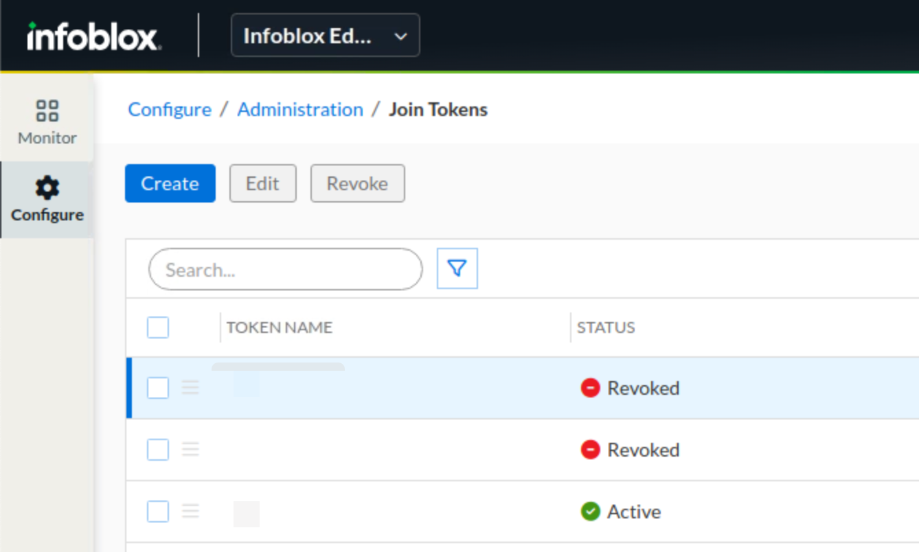

Task 1 Solution: Creating a Join Token
Before you deploy either server, create a Join Token and save it immediately. The token is used for authenticating the NIOS-X virtual servers during the joining process. The token string is only shown once, so capturing it now prevents you from having to revoke and recreate it later.

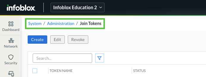

  2. Use your Education Infoblox Portal Credentials to log into the Infoblox Portal at https://csp.infoblox.com.
  3. Navigate to System → Administration → Join Tokens.
  1. Click Create.
    1. In the token name field, enter JT-1.
    2. Click Save & Close.

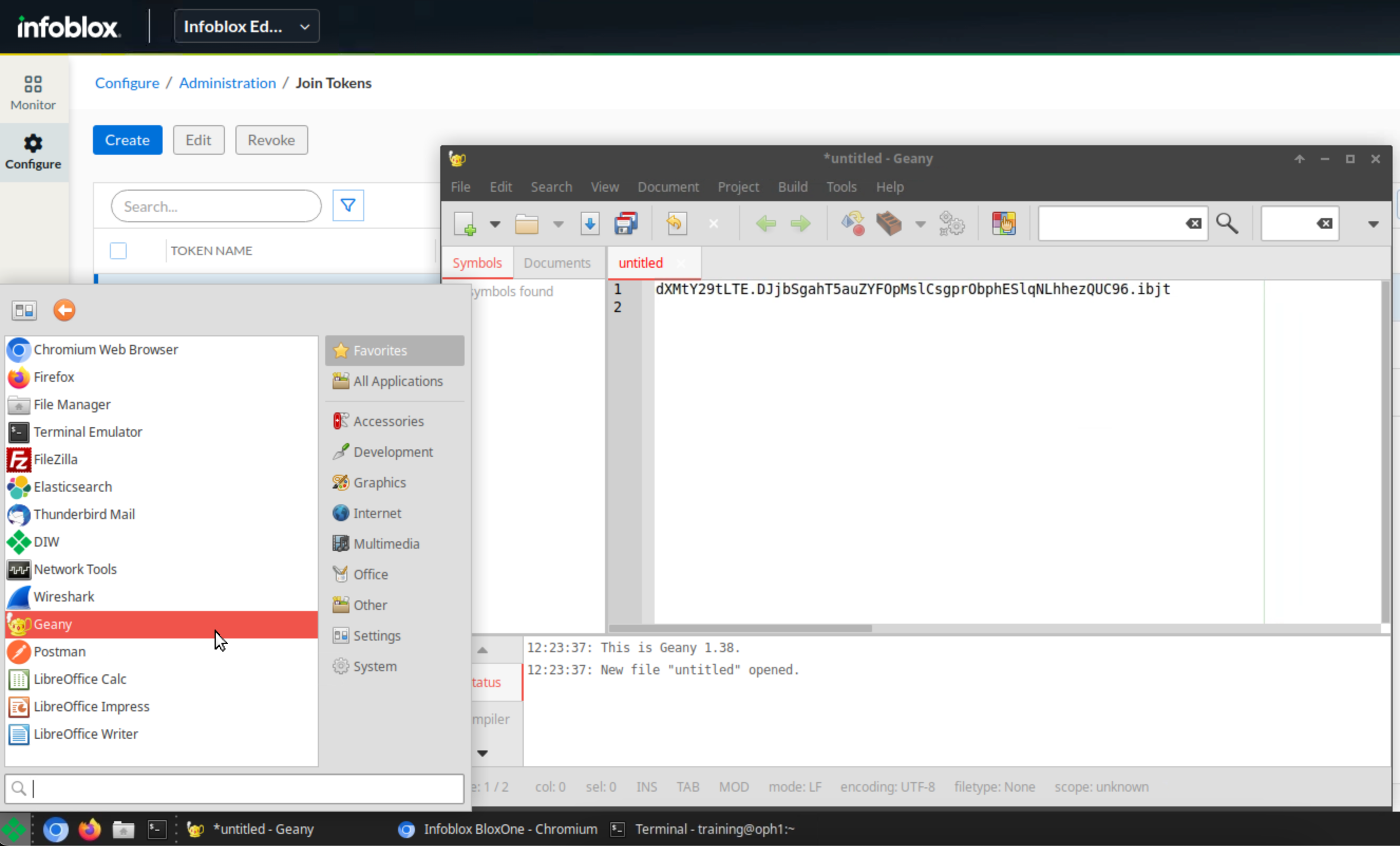

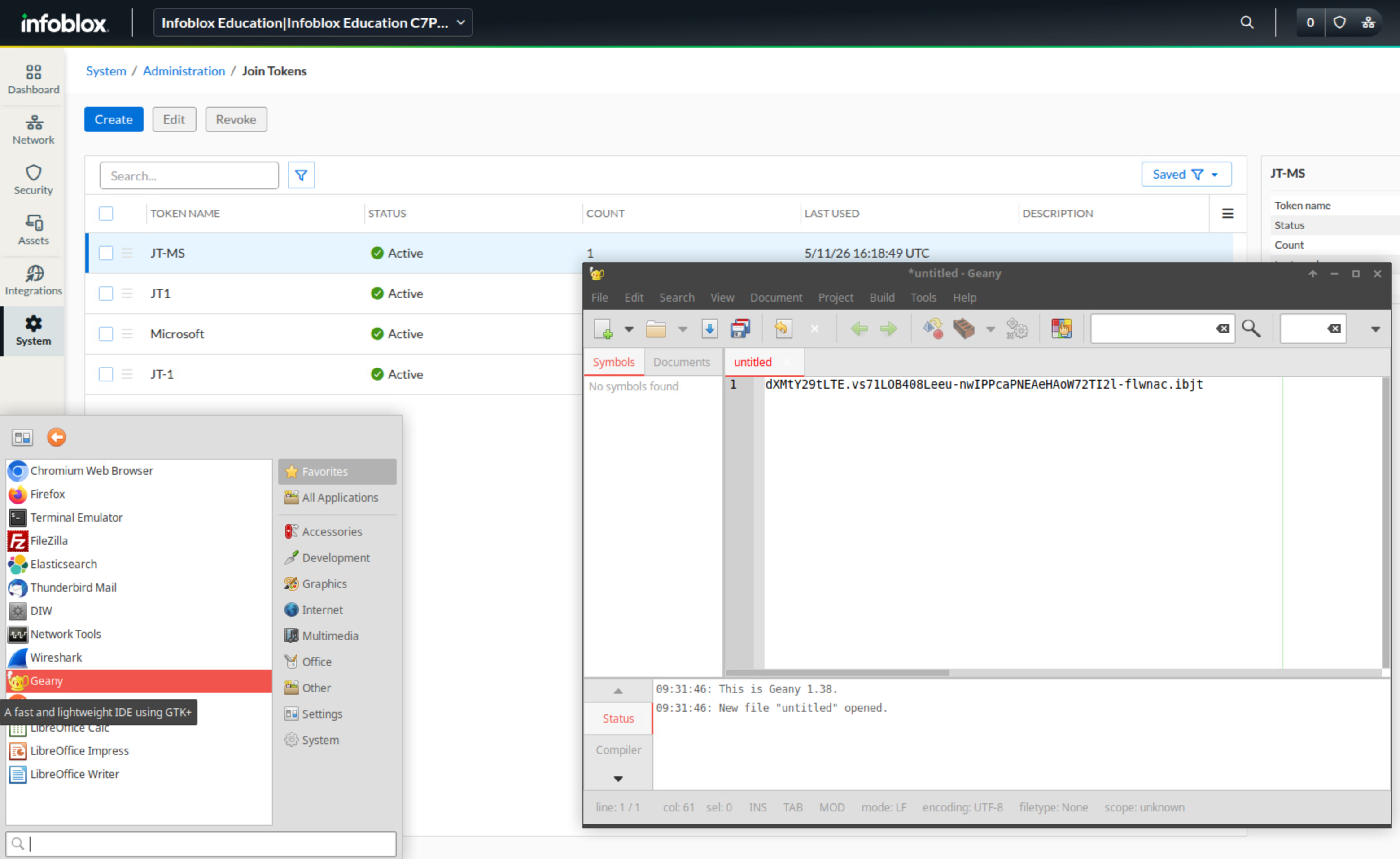

  2. Copy the token string from the pop-up window.
Save the Join Token string, as it will not be visible again. If you don't, you must revoke the token and create a new one.
  1. Open the text editor Geany on jump-desktop, then save the token string to a text file for later use.

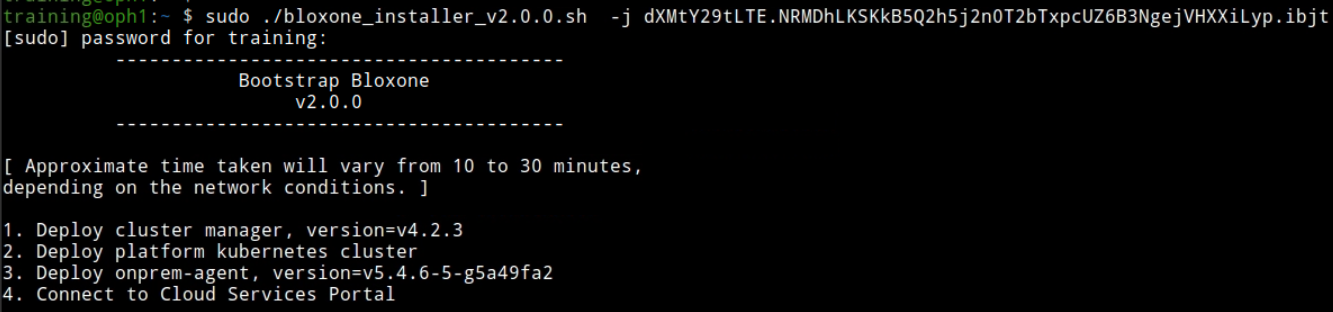

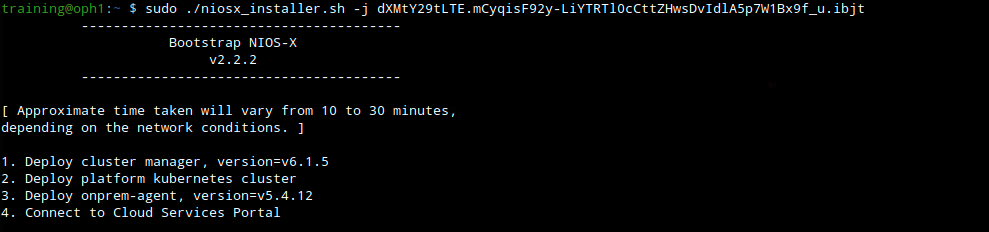

  1. From jump-desktop, open a terminal and connect to oph1 at 10.100.0.110 on port 65522 by using the command ssh -p 65522 training@10.100.0.110.
  2. When prompted, enter infoblox as the password.
  3. Download the NIOS-X installation script to the oph1 virtual machine using this command:
    wget -O niosx_installer.sh https://s3.amazonaws.com/ib-noa-prod.csp.infoblox.com/niosx_installer_v2.2.2.sh
  4. Make the installer executable by running chmod:
    chmod +x niosx_installer.sh

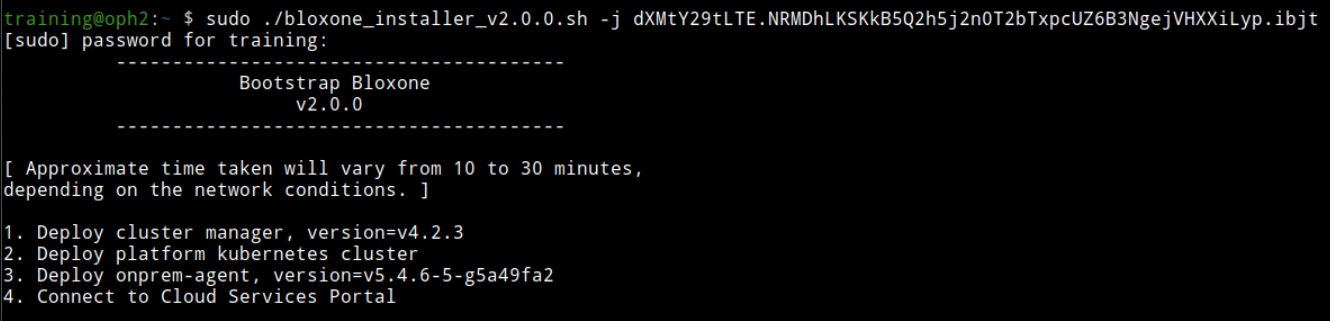

  5. Run the installer script, make sure you replace ‘paste-your-join-token-here' with the join token you have saved in Task 1.
    sudo ./niosx_installer.sh -j paste-your-join-token-here
  6. If prompted, enter infoblox.
  7. Wait about 10 to 15 minutes while the server updates and synchronizes with the Infoblox Cloud.

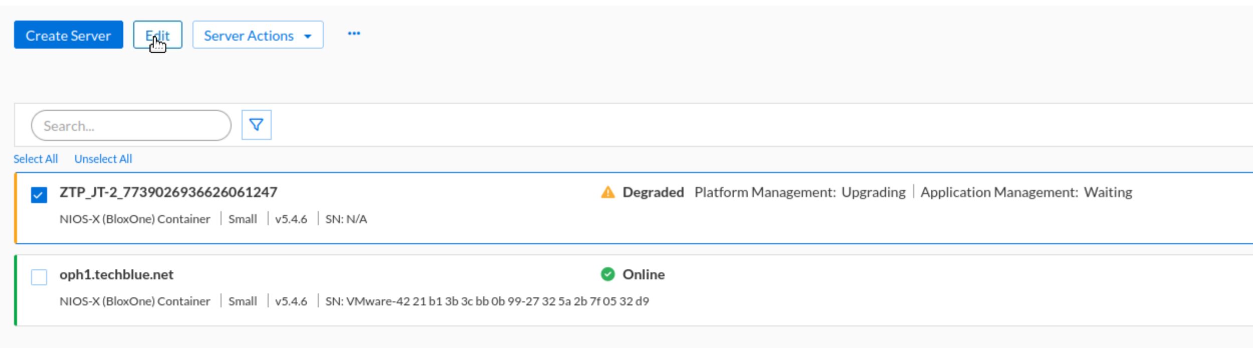

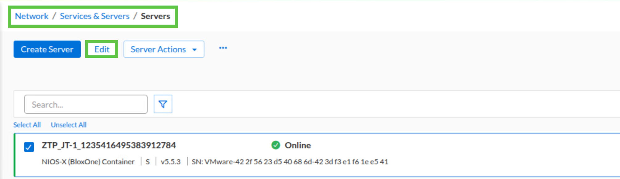

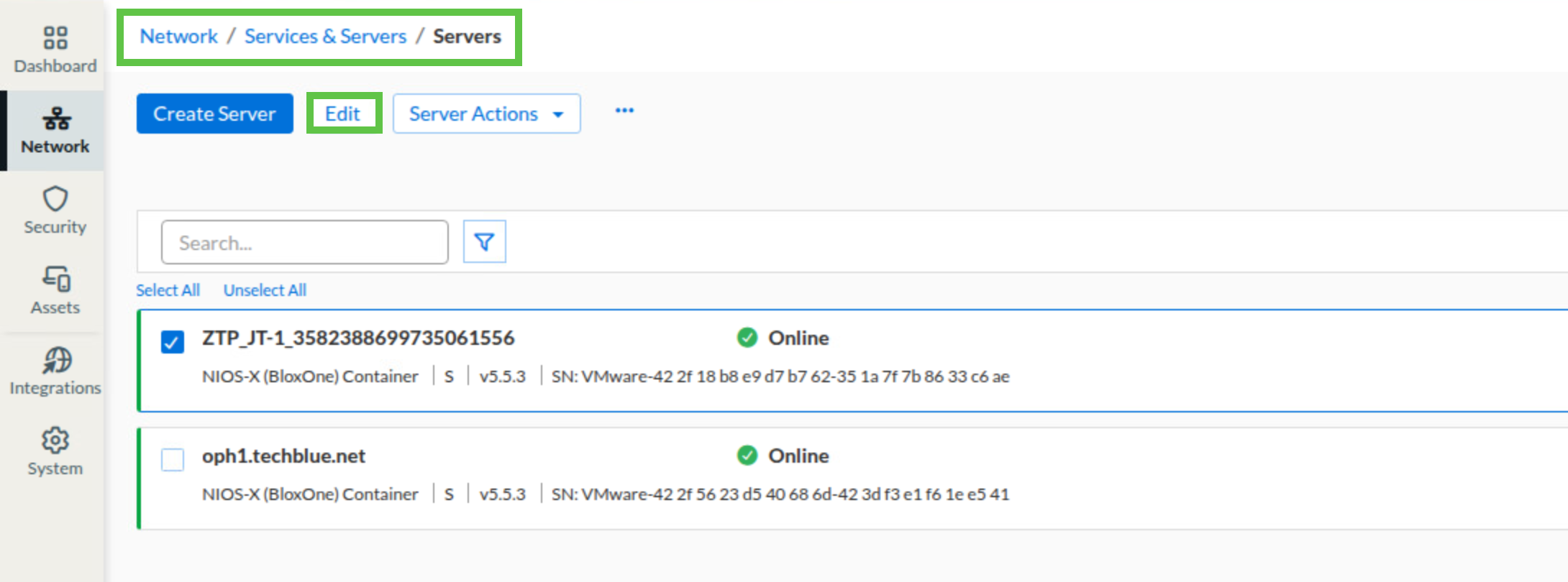

  8. In the Infoblox Portal, navigate to Network → Services & Servers → Servers.

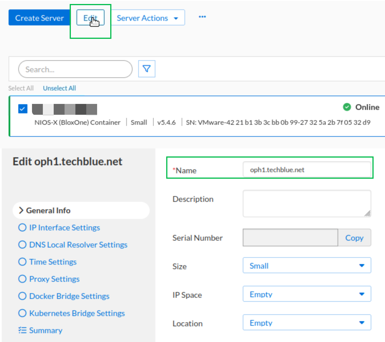

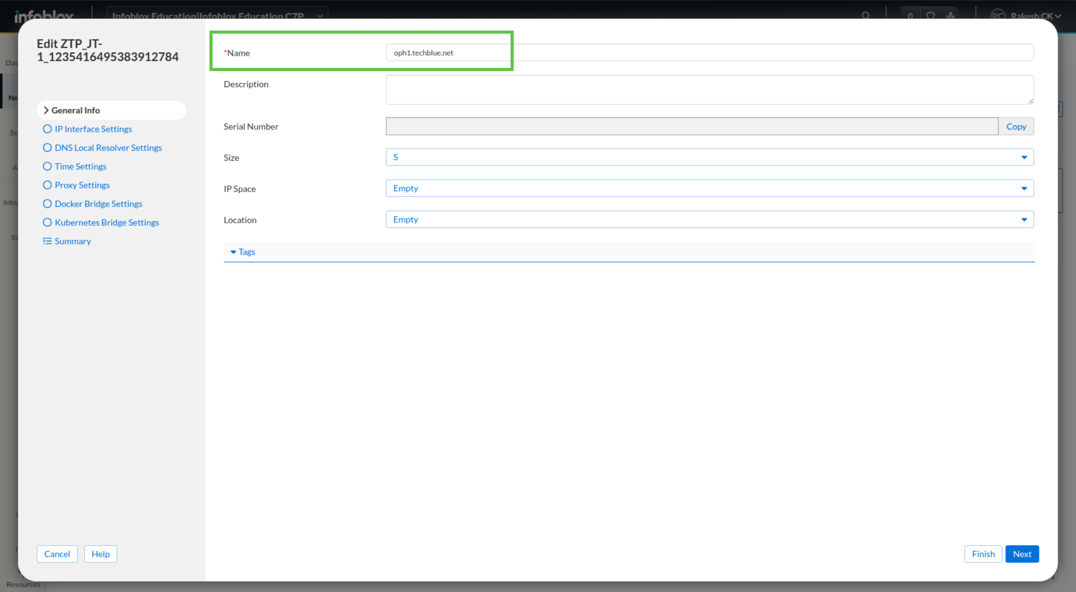

  9. Select the deployed NIOS-X virtual server and click Edit.
    1. On the General Info tab, change the server name to oph1.techblue.net.
    2. Click Finish and then Save & Close.

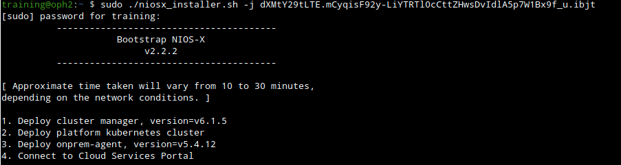

  1. From jump-desktop, open a terminal and connect to oph2 at 10.200.0.110 on port 65522 by using the command ssh -p 65522 training@10.200.0.110.
  3. Download the NIOS-X installation script to the oph2 virtual machine using this command:

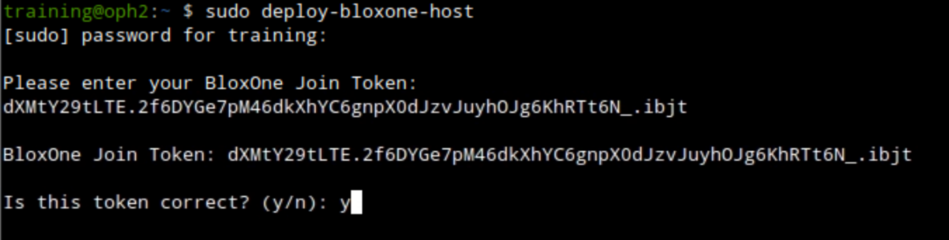

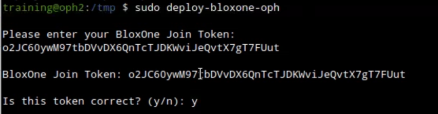

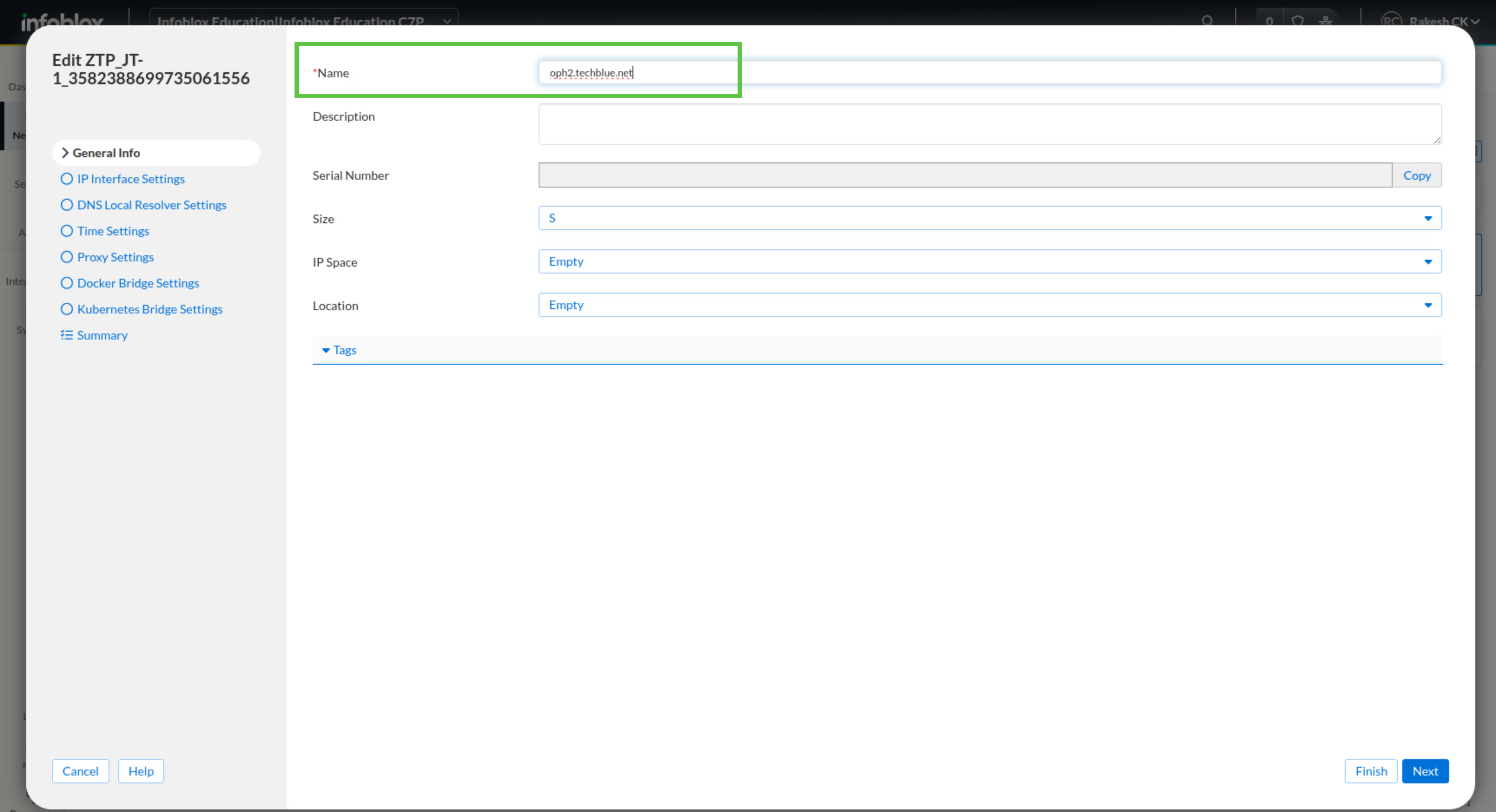

  7. Return to Network → Services & Servers → Servers in the Infoblox Portal.
  8. Select the newly deployed server and click Edit.
  9. On the General Info tab, change the server name to oph2.techblue.net.
  10. Click Finish and then Save & Close.
