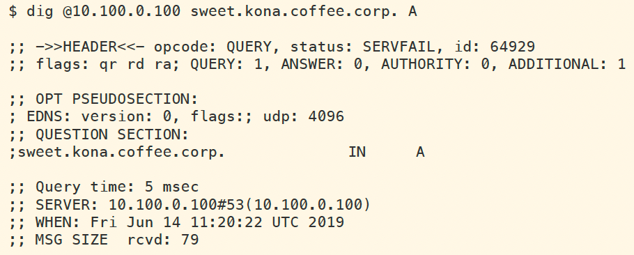

    2. Execute the following command on Jump-Desktop (10.35.22.10) and note down the results:
      dig @10.100.0.100 sweet.kona.coffee.corp. A

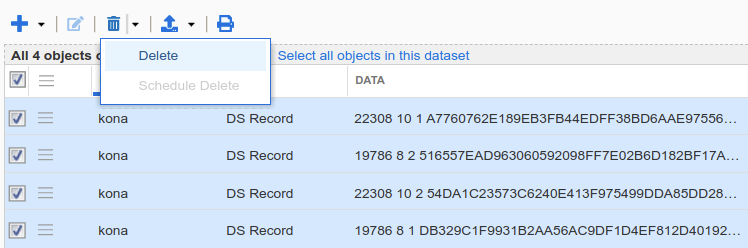

    5. Login to NS1 (10.100.0.111):
      1. navigate to Data Managment → DNS → Zones
      2. select kona.coffee.corp.
      3. delete all DS records for kona.coffee.corp

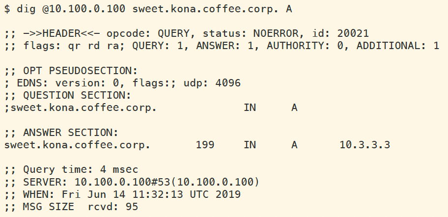

    6. Execute the same dig command again:
      1. What is the response after cache has expired or manually clearing the cache?

    After logging into NS2 and unsign the authoritative zone kona.coffee.corp, and waiting sufficient time (199seconds) for cached answers to expire, we use dig to look up sweet.kona.coffee.corp, and the response is shown below:

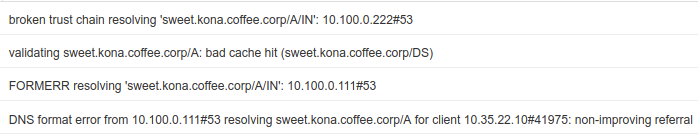

    This is due to the fact that the DS records on NS1 have not yet been removed, and validating resolver assumes the zone kona.coffee.corp is still signed, and failed validation. The following figure shows the log messages generated by the dig command, as seen on the validating resolver ADA (10.100.0.100).
    Login to NS1 (10.100.0.111), navigate to Data Management → DNS → Zones, select the authoritative zone coffee.corp, delete all DS records for kona.coffee.corp, as shown below:
    Wait for the DS records to expire from ADA's cache (199 seconds), and the query for sweet.kona.coffee.corp should work as an insecure resolution with no AD flag present, as shown below:
