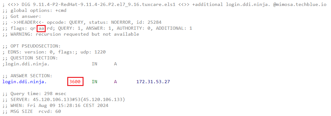

Task 1:Query an Authoritative DNS Server
Use the Dig Web Interface to look up the domain login.ddi.ninja. Use the DNS server mimosa.techblue.io.

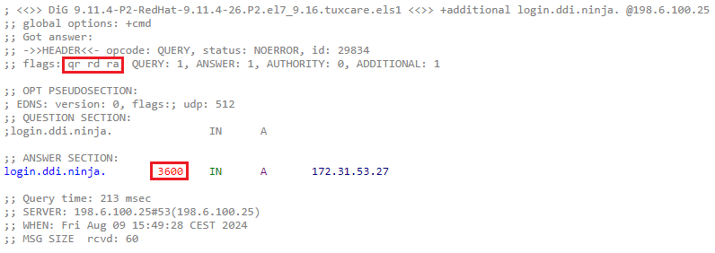

Task 2: Query a Non-Authoritative DNS Server
Use the Dig Web Interface to look up the domain login.ddi.ninja. Use the default DNS server (or any open DNS servers such as 8.8.8.8). Compare the response with the one from Task 1, focusing on the AA flag and the TTL value.

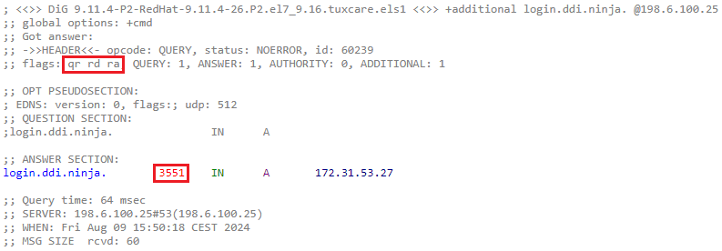

Task 3: Observe TTL Decrease in Non-Authoritative Response
Repeat the non-authoritative DNS query from Task 2 several more times at intervals. Observe how the TTL value decreases with each subsequent query.

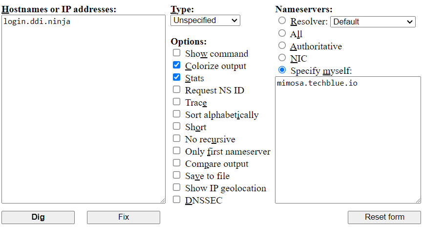

Using Dig Web Interface:
  1. Log into the jump-desktop virtual machine (training/infoblox).
  2. Open a browser window to digwebinterface.com.
  3. Enter login.ddi.ninja in the "Hostnames or IP addresses" field.
  4. Enter mimosa.techblue.io in the "Nameservers" field and select Specify myself.
  5. Enable the Colorize output and Stats options.
  6. Click Dig.

Expected Output:
The AA flag should be present, indicating an authoritative answer, and the TTL value should remain consistent across repeated queries.

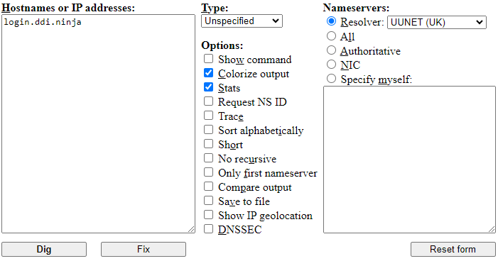

  4. Under the "Nameservers" field, select the Resolver option. From the dropdown, select UUNET (UK).
  6. Click Dig.

Expected Output
The AA flag should not be present, indicating a non-authoritative answer, and the TTL value should begin to decrease with repeated queries.
Task 3 Solution: Query a Non-Authoritative DNS Server
Repeat the non-authoritative DNS query from Task 2 multiple times at intervals using either the Dig Web Interface, dig command.
Expected Output:
Compare the TTL values in the responses after each query. Notice how the TTL value decreases with each subsequent query, reflecting the passage of time in the cached response.
When querying the same DNS recursive resolver, the TTL decreases with each repeated query because the TTL reflects the remaining time the response is valid in the resolver's cache. However, if your queries are directed to different DNS servers within a service provider's network—such as Google Public DNS (8.8.8.8), Cloudflare DNS (1.1.1.1), or OpenDNS (208.67.222.222)—the TTL might not decrease consistently. This is because your query could be routed to a different server each time, and each server has its own cache, resulting in varying TTLs.
