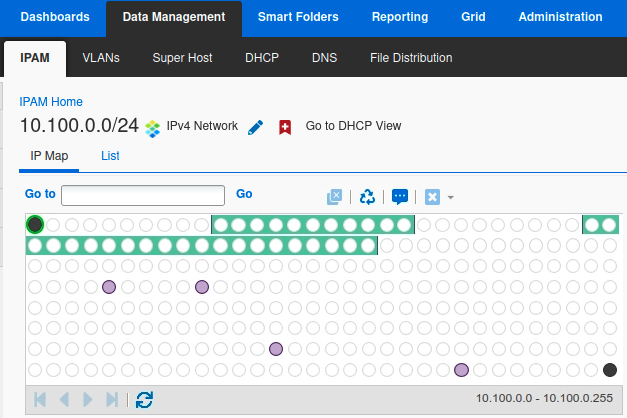

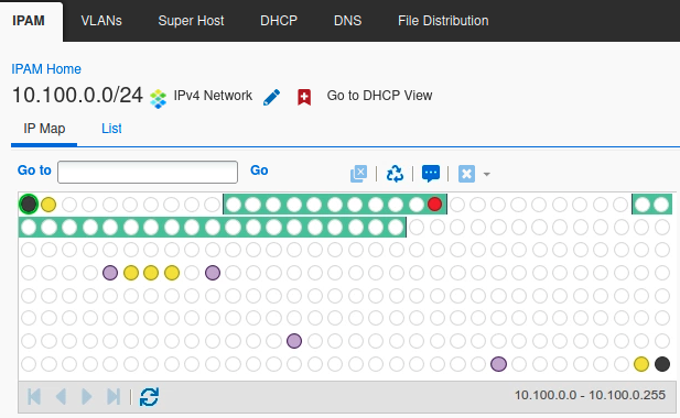

  1. In the GM web interface, navigate to Data Management → IPAM.
  2. Go to the network 10.100.0.0/24, and select the IP Map view. You should see something similar to the screenshot below.

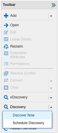

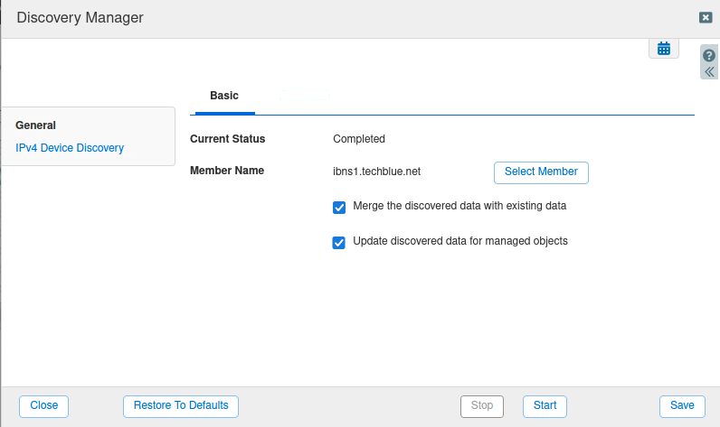

  3. In the Toolbar, click Discovery → Discover Now.

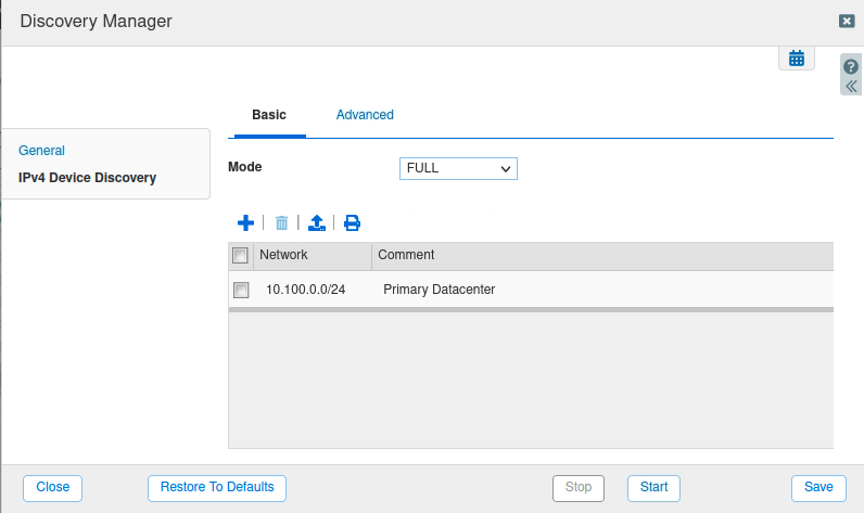

  4. The Discovery Manager dialog appears.
  5. In Member Name, change member by clicking on Select Member and choose ibns1.techblue.net.
  6. Click on the IPv4 Device Discovery tab and confirm the mode is FULL, and the network 10.100.0.0/24 is listed.
  7. Click Save. Then click the Start button, this will perform a one-time discovery on the network.
  8. You may click Close and the discovery will continue to run in the background.

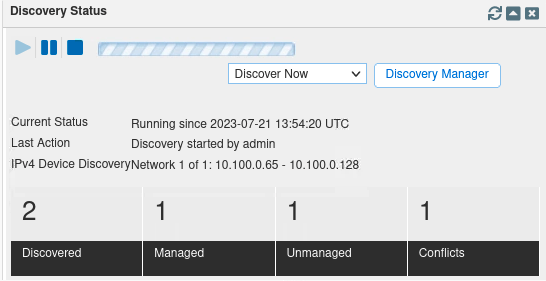

  1. To check on the status of the discovery, navigate to Dashboards → Status.
  2. Find the Discovery Status widget. It displays the current progress of discovery, including the number of discovered, managed, unmanaged, and conflict IP addresses in the network.
  3. Wait for the discovery to be completed. This could take a few minutes.
Task 3 Solution: Identify Unmanaged Hosts (Yellow)
  1. Navigate to Data Management → IPAM, to the network 10.100.0.0/24 → IP Map.
  2. The IP Map is now updated with the results from the network discovery. You should see some yellow entries.

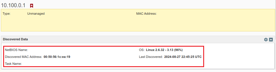

  3. IP Addresses in the network show up in yellow because they are unmanaged.
  4. Click on the first yellow entry, the IP address 10.100.0.1. Additional information is displayed when you hover over the entry and at the bottom of the screen. In this case, NIOS has discovered the MAC address associated with the IP and has identified the operating system running on the device, along with an assurance percentage.
Note: An unmanaged IP address is a discovered host, not previously known to the appliance, does not have an A record, a PTR record, fixed address, host address, lease, or is not within a DHCP range. You can convert an unmanaged address to a host, DHCP fixed address, A record, or PTR record.
Task 4 Solution: Identify and Resolve Conflicts (Red)
  2. You should see one red entry (conflict).

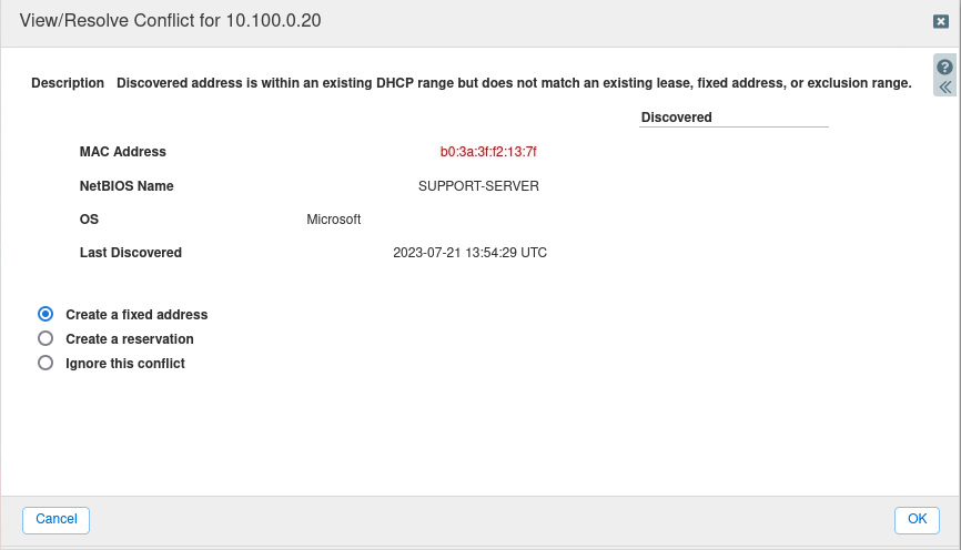

  3. Click on the red entry (conflict), the IP address 10.100.0.20. Additional information is displayed both when you hover over the entry, and at the bottom of the screen.
  4. With the conflict entry highlighted, click Toolbar → Resolve Conflict.
  5. The description reads: “Discovered address is within an existing DHCP range but does not match an existing lease, fixed address, or exclusion range.”
  6. At this point, you may choose one of the 3 resolutions:
    1. Create a fixed address: If you choose this option, the IP address 10.100.0.20 will always be assigned to the MAC address b0:3a:3f:f2:13:7f.
    2. Create a reservation: If you choose this option, the IP address 10.100.0.20 will be reserved and never assigned to anyone.
    3. Ignore this conflict: You may need to investigate further before deciding what to do. If that is the case, choose this option.
The most likely option, given the circumstances, would be to Create a reservation. This will prevent a potential IP address conflict when the DHCP server hands out 10.100.0.20 to another device, while you investigate the root cause of why this MAC address b0:3a:3f:f2:13:7f is on this address. There are two possibilities:
